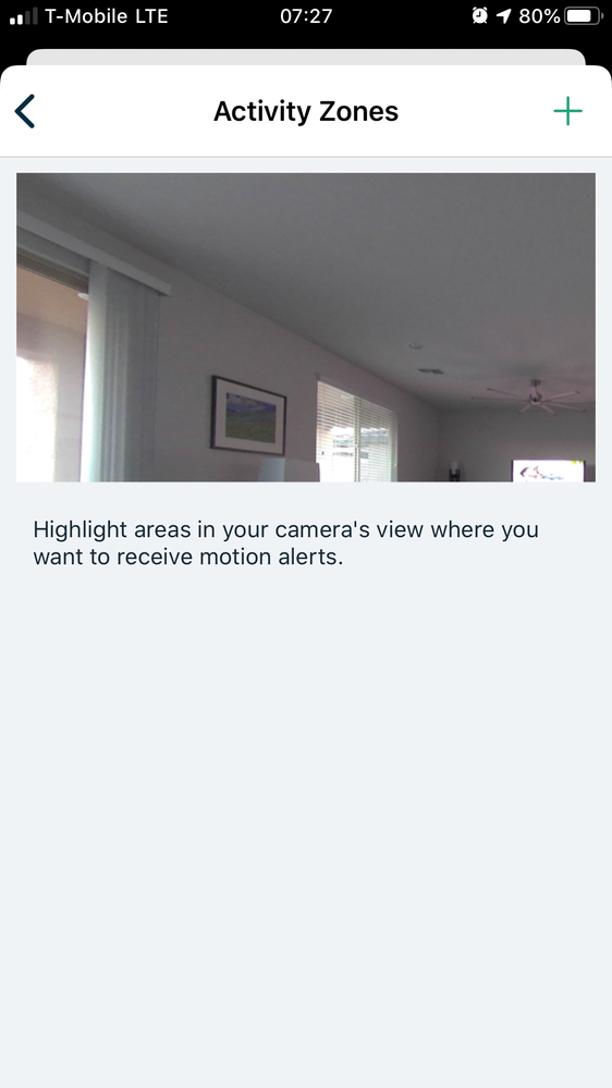

Not able to set activity zone, only upper left of field of view is shown. Tried to change camera field of view, flipped 180° and back, tried all video adjustments and still same thing. Also on this camera the audio icon is grayed out but it works flawlessly.

I am having the same issue, activity screen only showing upper left part of field of view. The live feed is fine only the activity window. Also on that camera the audio icon is grey but the audio is turned on and is working.

Yes I have done that and I did it again and all the happens is that it refreshes the image to a current one but it is still just the upper left portion of the full field of view.

Has anyone been able to find a fix for this? I have contacted Support and I guess a higher level support will contact me. I have the same issues as above. My preview screen (not live) but under Video Settings will zoom to the top left, the weird thing was that once I unchecked "Local 4K Live Streaming" it would go back to normal. I was able to replicate this for hours on out yesterday and now today I tried to do the same and now it doesnt work. Arlo please fix this issue ASAP. We cannot setup a Motion Zone if the camera is Zoomed or Pan to the top left!!

How many cameras do you have that do this? I have tried everything and no luck, the closet thing I found was when I removed it from the hub then reinstalled it. When it first came up it had the full FOV image them it flickered in between the limited upper left image and full view like in 3 seconds it toggled in between them and then stayed on the upper left zoomed image. So from what you said it all worked before then since the update you have seen this. I was wondering why I did not see anything like I was seeing in the forums. I was thinking it may have been a hardware problem since only one of my cameras is effected. Are all your cameras showing this anomaly?
