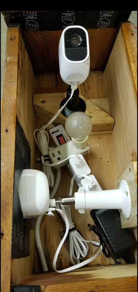

Here is what we came up with for my families cameras in Montana. These are wooden bird houses and inside is a small low watt bulb which switches on once the temp drops. Heats the inside up and keeps the cameras warm all winter. The photo shows the inside with the front of the house removed. Been using this set up for several years now and haven't had any problems with cameras shutting down due to cold and signal strength is good. Multiple cameras outdoors that are as much as 100 yards away from a base station inside the house.

 I LIKE the idea of wooden bird houses!
Radio waves pass through wood pretty well, and it’s something I can do in my shop.

No prob! One thing to take note, I'm not sure about the Ultra's but on the Pro2's we had to have the cameras stick out about an inch or so from the wood because the IR light would reflect and wash out the camera view at night. We just adjusted the thickness/amount of wood the camera mount had under it until the night view cleared up. We also mounted some Tandelux 80ft IR illuminators on the outside of the box which made all the difference in the world at night. They are cheap at $20 or so and have lasted years so far.
