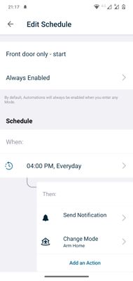

3. Set up the schedule for 'Front door'; please note that adding 'Notifications' into the rules allows you to customise your notifications. In my case, I disabled all options for 'Notifications' so I don't get notified if motion on 'Front door'
