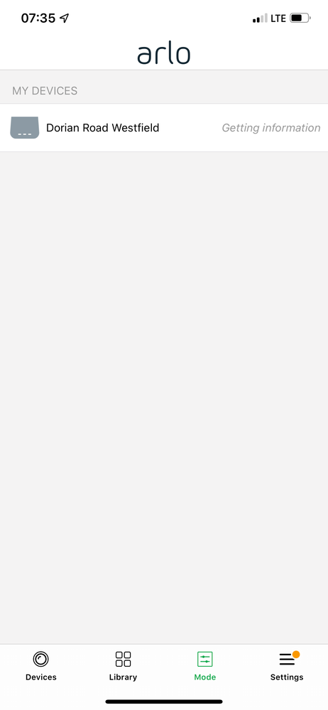

When Arlo doesn’t send push notifications and miss recording motion have ever checked the ‘mode’ and is set to ‘armed’ or whatever mode you have selected or does the mode show ‘getting information’ instead in the mode section from the app?

The only way I’ve found to fix the mode showing getting information is to reboot the base station which happens about 2-5 times a day (screenshot attached).
