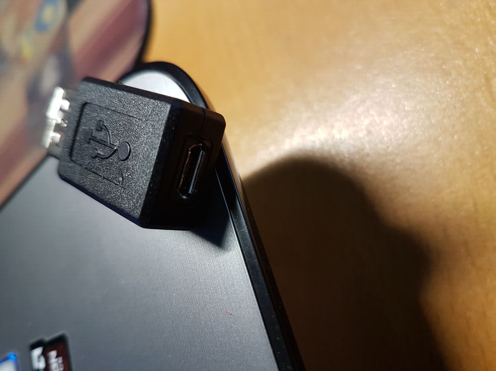

You could try some of these connectors USB 2.0 Female to Micro USB Female...
I used them to extend my power cord to my Arlo Pro3 Cam
https://www.amazon.com/gp/product/B07GJJLNX7/ref=ppx_od_dt_b_asin_title_s00?ie=UTF8&psc=1
