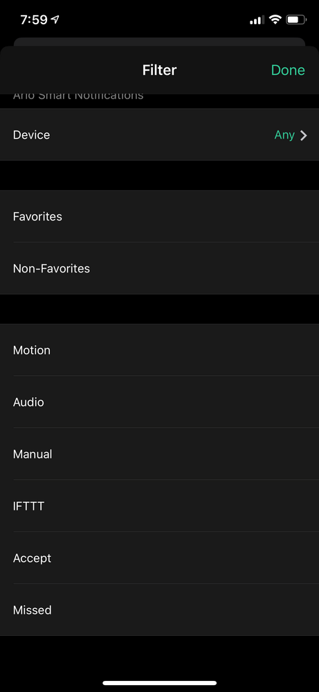

In the filter section in video library there is a string of text at the top that reads "Arlo Smart Notifications" problem is the text is cut in half (see attached image) this text should be removed as is not necessary.
If we want to buy a subscription we will, no need to spam customers who have paid thousands of dollars already on this system.
