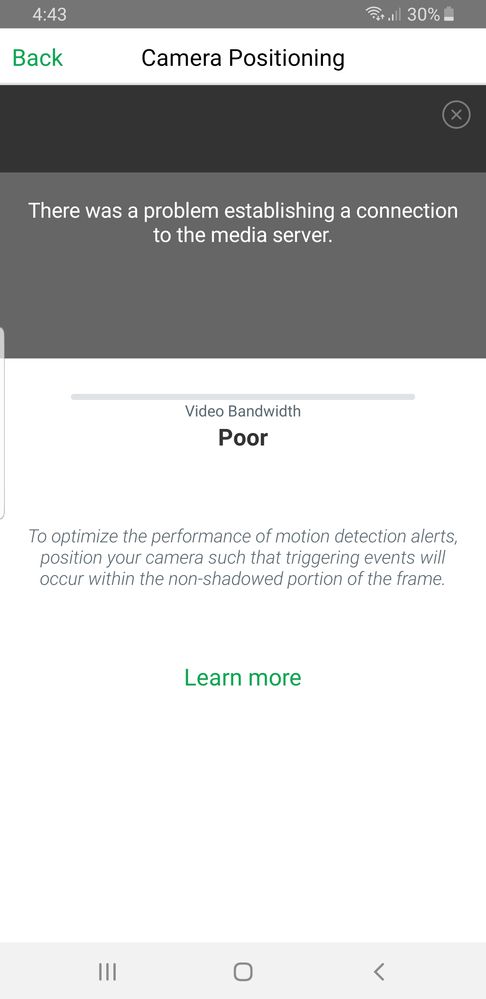

I have the same problem with my new Arlo installation of 2 Ultras.
In addition, if you go to Device Utilities/Camera Positioning it states "There was a problem establishing a connection to the media server"
Have tried all standard fault testing including factory reset and close proximity testing

I also am having the same issue with zero length recordings ever since the last upgrade. Is there any news when this will be fixed? I'm posting to a chatroom on it

Having the same issue, just purchased the Ultra and get nothing but a connection error on the PC or white screens on iOS; the audio and light works but video does not, nothing records, can't even enter in positioning mode without getting a media server error

maldick
I still have the same issue with my new Ultra 2-pack setup. Been waiting a while now for a fix....
maldick
it now works after the latest firmware upgrade
