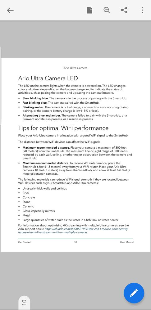

The problem may come from WIFI interference.At least , try to position you smart hub away from the internet router at least 1.8meter as manual by buying the new lan cable to extend the gap between 2 system .For my house , i use 200/100 Mbps cable ,it still slightly lag when we use live 4k but it is ok to use.Even it said require 4Mbps/camera but if you power up all 4 cam ,it mean at lease you require 16Mbps of internet which does not include your normal use for the other devices in your home.May be first , try to extend gap between two system first ,if it does not work ,you may consider to up speed of your internet.

PPP-001
Manual
https://www.arlo.com › en-usPDF
Arlo Ultra User Manual
They suppose to emphasize user to check out their manual.😒😒😒 A bit weird Arlo company
