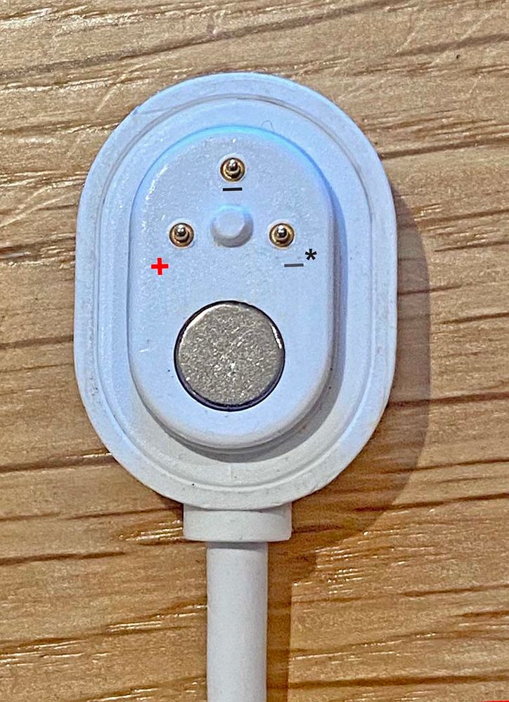

On the image below:
1. For Solar Power mode, there is a 468k resistor connecting the third pin (indicated as "-*" in the image) to the negative pin.
+ = +7.5v
- = negative
-* = negative with 468k resistance. (shows 7.1v on positive)
2. For charging mode.
+ = +5v
- = negative
-* = not used
