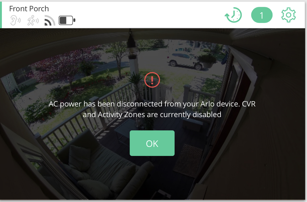

Same issue, we just discovered that activity zones now require AC power, and I just posted about it. What a SERIOUS mistake by Netgear, absolutely ridiculous. But yeah, the most defining feature of these cameras now require them to be plugged in, which defeats the whole purpose of these being marketed as WIRELESS CAMERAS!
NETGEAR: WHY DID YOU DO THIS???
If you look at the verbiage when you unplug a camera, it now says 'activity zones will not work if you aren't on AC power'...I only stumbled on that today after trying to figure out why we also have no cloud recordings since May 28th, and that's gotta be it. I'd attach a screenshot, but it has a file type of .jpeg, and their stupid forum software only allows .jpg (I'm on a tablet and can't change the filetype extenstion). They nerfed them, otherwise they verbiage wouldn't say that.
I converted the jpg to a png. Also, to whomever maintains this website: The original image was .jpg extension, yet apparently your website renames it to a .jpeg...and the .jpeg extension isn't allowed by your system? Why would you change the file extension to something that isn't allowed by your website??? Wow.
Anyway, you can see the error now says that activity zones are only enabled when the camera is on AC power. Absolutely mindblowingly dumb.
@BinaryDichotomy I may have missed it in your several posts but are you on battery or AC power. Activity zones require subscription on battery. I believe the error you are seeing is a bug many have seen no matter what. . CVR always needed AC power. Activity zones seem to not working for many no matter what.
