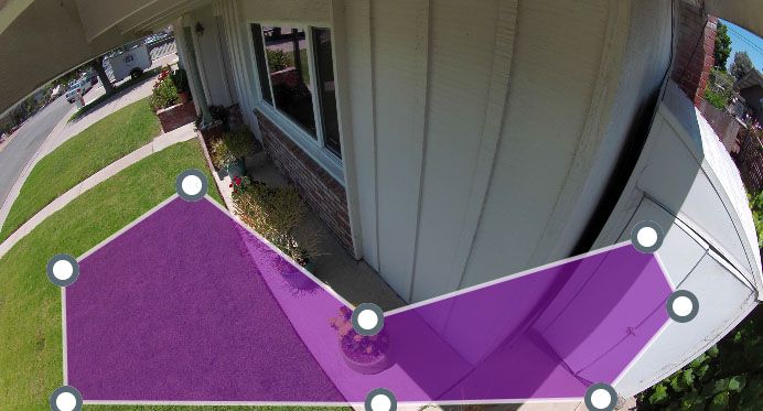

I have 2 Arlo Ultra cameras, mounted in the front of my house. Both are AC powered. The “West” camera functions correctly. The “East” camera records every car that passes by the house. The street is just a very small portion of the coverage area. The active area (purple) does not cover the street (or even close). The “Smart Notifications” only is triggered for people. The motion detection is set to 50. The microphone is on with wind reduction. I have reset the activity zone numerous times. I have deleted the device and reinstalled. I still get false triggers on cars, forcing me to screen many false triggers.

I appreciate your suggestions, however, I think something more is going on. Notice the enclosed “West Camera” photo. The West camera is closer to the street and the coverage includes much more of the street than the East camera. However, the West camera does not false trigger. This does not make sense, if anything the West camera should be the one having problems. Also note that both cameras have active zones that exclude the street. There seems to be an inconsistency in the way the camera’s trigger. Does anyone have a solution?
East
West

The whole point of setting up zones is to be able to exclude areas such as the street. The question to the ARLO team is why doesn’t the activity zones work as advertised? Many users have the same exact problem with cars and people outside of the defined activities zones triggering the camera. The ARLO must, by now, know exactly why this is occurring. ARLO team... please explain.
