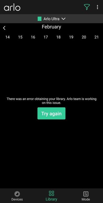

I am having issues with the Direct Storage Access feature on my VMB5000r4 base station. It used to work fine but now I can no longer access local videos through the App, error message as follows:
Key investigations performed so far as follows:
- Checked for firmware updates I'm on 1.19.0.3, I see there is a later version 1.20.4.1 (I think), but my Basestation won't pick it up. Even tried adding a camera to force a firmware update but it says no updates available
- Rebooted base station
- Rebooted router
- Toggled the "Direct Storage access" and "Record Locally" off/on
- Removed the SD card and confirmed local video is still being written to it (even though the App won't load it)
- Tried on both Android and iOS devices (same symptoms)
- Re-iped the Basestation just in case
- Tinkered with router settings (enabled uPnP and Port Triggering) which shouldn't really matter but didn't work anyway
Any help would be appreciated.
Thanks
