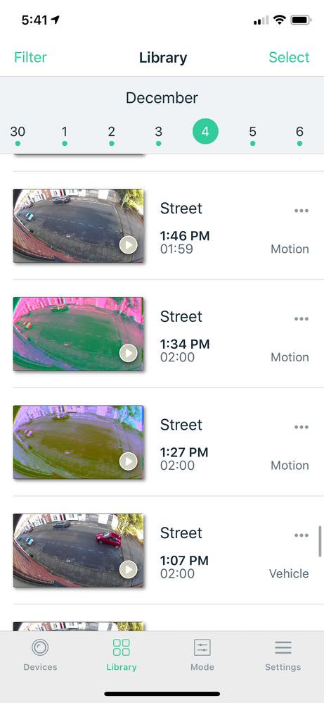

MAD! Also one of my arlo ultra in night time records kinda brown/grey and then in morning overexposed pink, green, brown... different morning different color ... now i'm not sure is that the updates fault or my arlo camera went bad after all this madness !

Look at this video colors

And here is more easter egg looking colors 😮
