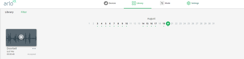

Hi,
since Aug 19th after 11:08pm (UTC +1):
My VMB5000r4 when camera detect motion:
- does not record any video in Library.
- does not send notification to my email address
My doorbell Detect Motion but:
- does not trigger the associated Camera recoding
I have received yesterday night a motion detection notification on my android phone from one of the Arlo ultra camera but I could not view any video in library.
The arlo-Q camera connenected to My NIGHTHAWK rooter is working and send notification as expected
I have disconected and reboot the hub Several time.
is there anything that can be done to get it fixed.
rgds
Jean
