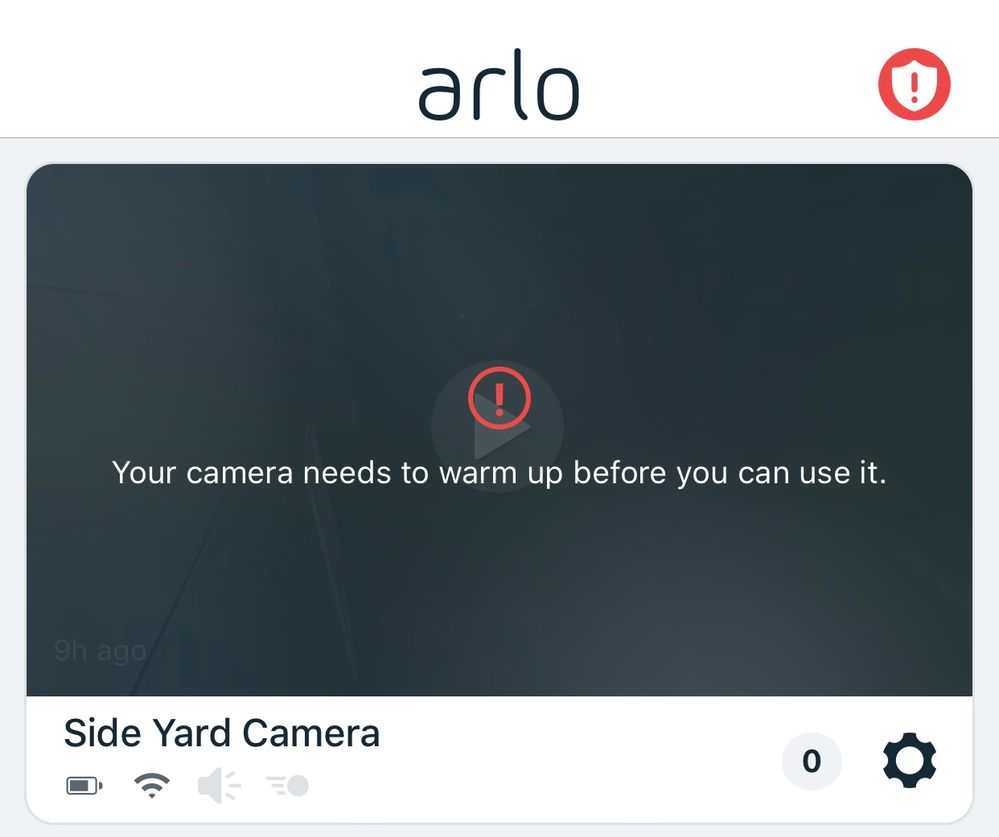

I was wondering what the operating temperates are for the Arlo Ultra? It seems my outdoor Arlo Ultra Camera is stating
“Your Camera needs to warm up before you can use it.”
I’m in Northeast Ohio and we have been hit with an attic blast and the temperature right now is -2 degrees.
Please let me know.

Operating temperature is -4°F to 113°F (-20°C to 45°C).
It sounds like it's a little colder where your cameras are located.
Yes, it is on the side of my home, which gets no sunlight at all, so I would say it’s atleast anywhere from -3/-5 degrees.
