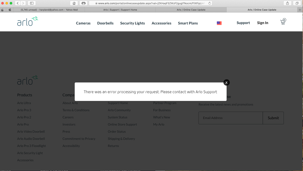

i created a help ticket then i just received a reply but when you try to update the ticket it just got to an error screen so i cant update or respond to the ticket,  so now it will probably be closed without ever being resolved.
If anyone at Arlo sees this  my case ID which is 41662931 please contact me

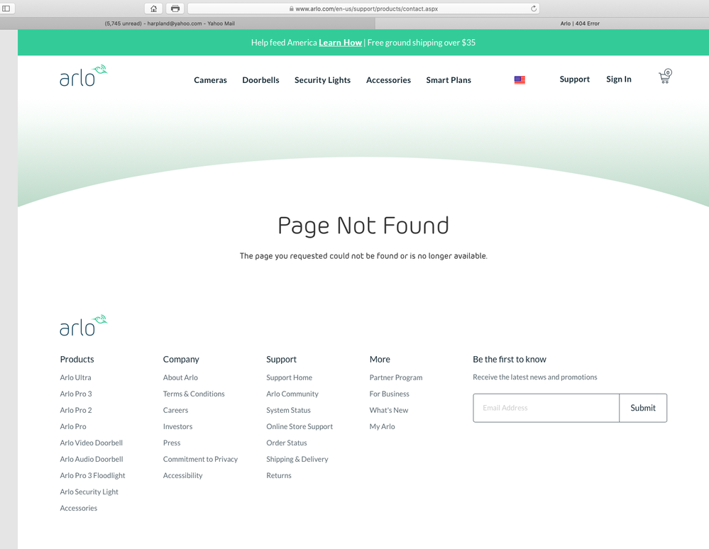

Yes i have tried different browsers and different devices,  and every ticket / case that i try to reply to ends up with the same error message, which is extremely ironic, "There was an error processing your request. Please contact with Arlo Support"!   then you click on, "Contact Arlo Support"  and you have to click through 10 different options and end up with a, "Page not Found Message".   Again this seams to be a very common issue in the Arlo Community,  When i plug my camera into the charging cable it works fine for most of the day,  then  after 5-7 hours if you try to view the live stream it will not work,  it just shows, "Connecting" when you try to view live,  if you go to camera the camera will still sometimes show, "Connected".  Then if i unplug the camera power cord,  within 10 min the camera is working perfectly again, allowing me to view live and to record video, etc.   Throughout this (Camera plugged into and unplugged,  the basestation is showing the solid blue light that it is synced with the camera,  I have reset the router,  changed the channels to 1, 7, and 11 with no improvement,  the router / wifi download Mbps is 29.1 and upload is 10.9  so that shouldn't be an issue either.   Again the common denominator is the power connection and or electrical current interfering with the camera connection.  Non of the previous tickets / cases for the last 2 years with this issue seam to have been resolved and Arlo seams to be going out of the way to avoid trying to support their customers.  If i wouldn't have paid so much $ for these cameras i would just eat the cost and start over with a new system.
