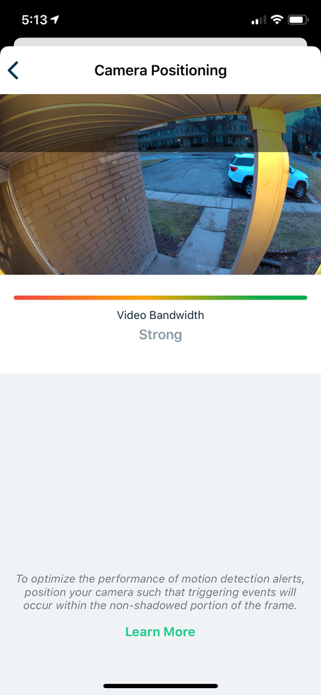

I even used the Camera positioning utility but still, I'm getting notification outside camera detection area!! Really annoying because my house is on a road with lots of car traffic.

Can you Please post screenshots of the device utility screen showing the camera positioning with gray area?
I changed the settings earlier today. The gray area does go up to the street level but I created three activity zones just under the street. Would I be getting three notifications when motion have crossed all three zones?
I will be deleting the activity zones and rely on area outside the gray area. I just noticed this:
