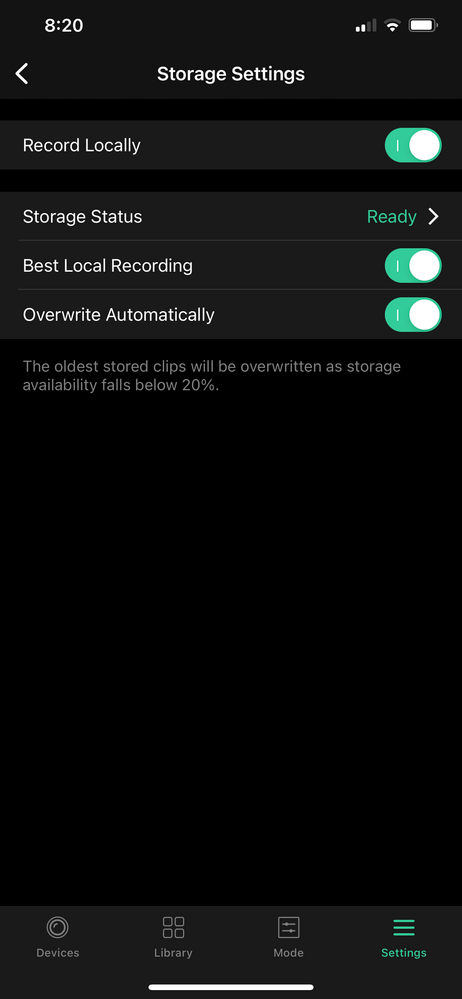

Should’ve posted this here. But I’ve tried everything and it still won’t show me the option to select my offline storage.
I’ve reinstalled, reseted and even tried in other devices. Won’t let me select my base station when in the library section.

Can you confirm your base station model? There is a label on the base that starts with VMB.
If it helps, I had the local storage option about a month or two ago. That’s why im so confused
@ThatPRDude wrote:
VMB4540r2
I'm confused too. You should see the option for direct access to local storage in the iOS app with that base.

I'll try to upload few images in hopes that it helps identify the issue.
