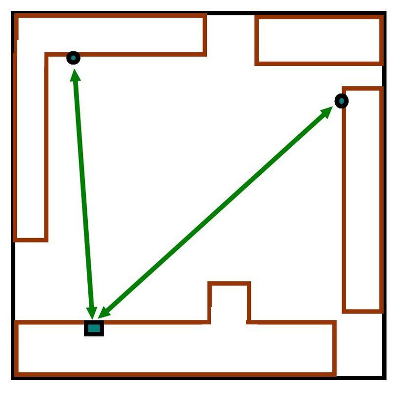

It seems to me that there is a good wifi connection between the HUB and the cameras. Indeed, on the application (samrtphone), I have two bars out of three. In addition, the cameras are located in a closed courtyard. The hub is placed behind a window in direct view of the cameras at a distance of respectively 28 meters and 33 meters, without obstacles.
Could the distance cause it ?! Personally I doubt it.
