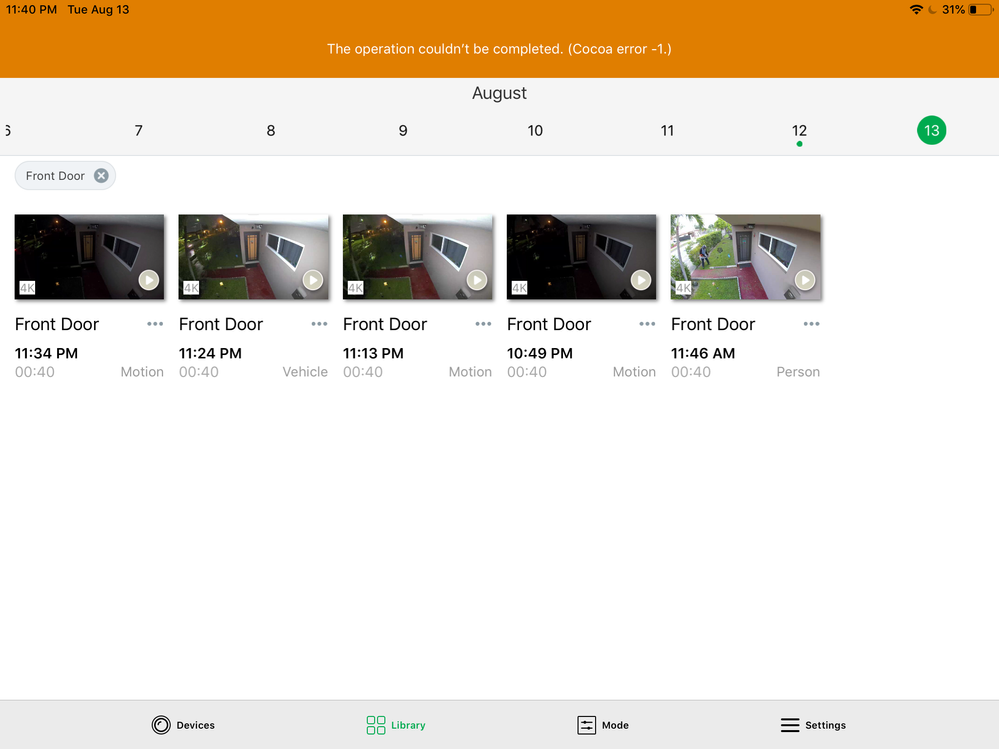

But I want to download any video from the library the system give me this error.
Cocoa- error( see screenshot attached)
