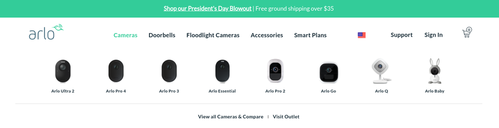

The attached image is what I see when the mouse cursor hovers over Cameras. The compare is at the bottom of the screenshot.

Go to arlo.com. If using a mobile browser, set it to use the desktop version of the site. Hover over the Cameras (or click on it) and choose the comparison link.

If I go to arlo.com and hover I get a Learn More button, but no compare option, even on two different browsers and I'm using a desktop.
