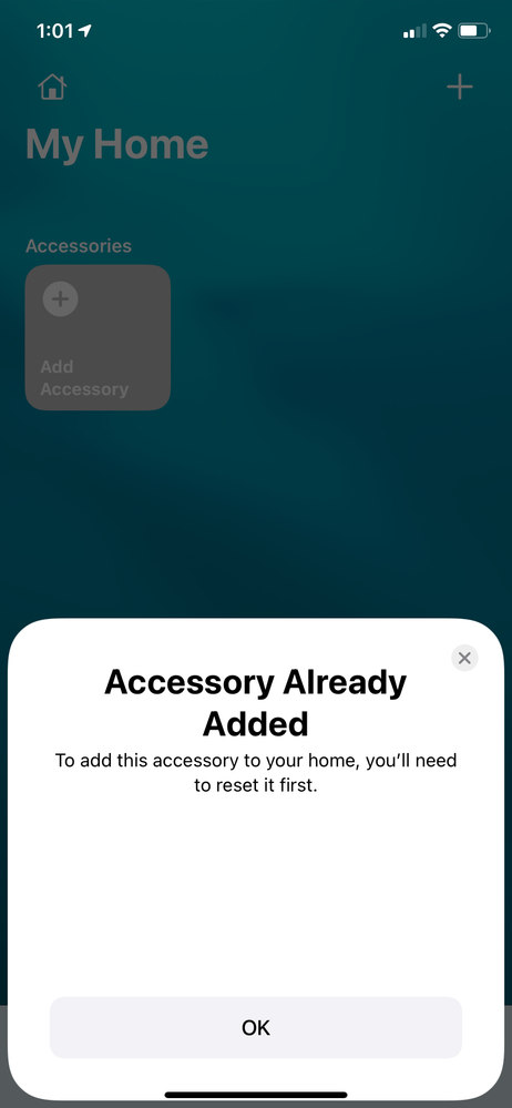

NTM
Now I’m getting this message. I’ve restarted the base several times and still won’t show up in HomeKit.
