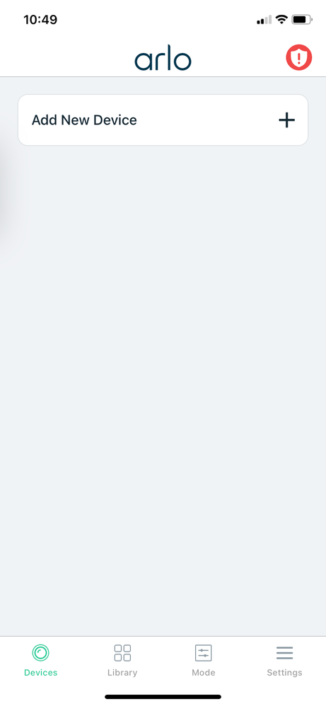

I’m not seeing that’s the concern when I’m on my phone profile is all there but nothing under cameras or options which you normally would have access to so I deleted my old info and tried to reconnect the system by linking the base it states on the phone searching and then states unable to find I will try to send you a picture

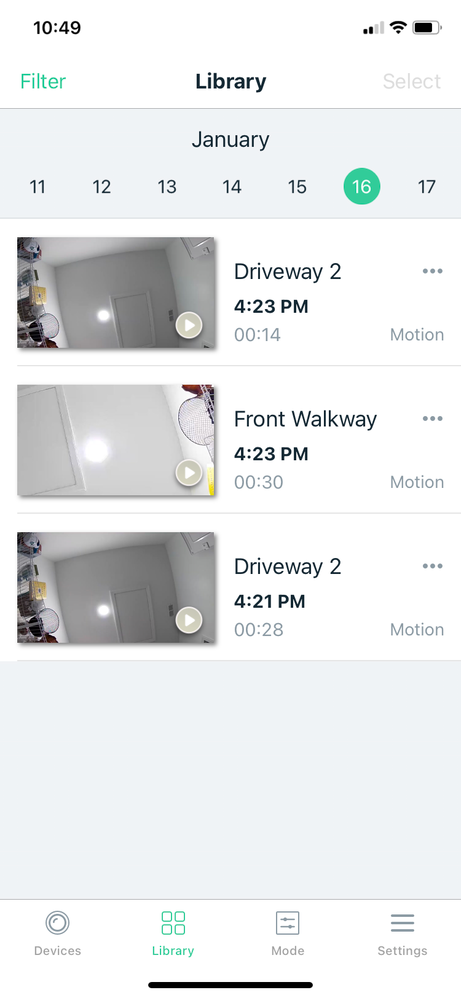

I attached a picture of the cameras showing movement in the laundry area where I was liking them so I have internet but no info for control will send you next picture
Here is the Home Screen
WHat is the LED on the hub showing? SHould be solid blue. You can try pressing the reset button until the LED starts flashing amber. Let it reboot to solid blue and try claiming again.
