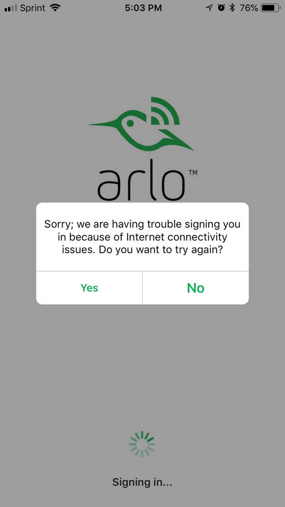

I have spectrum cable and cannot access my Arlo account.  It says ...internet connectivity...try later

Still getting error message about internet connectivity. Using iOS with AT&T

We have not been able to login for two days because of internet connectivity issues??
