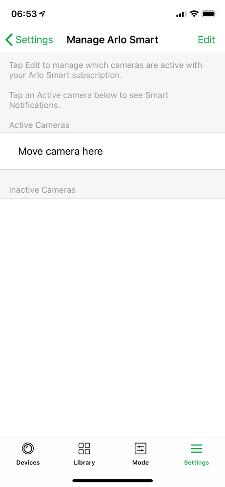

I bought an annaual Smart subscription for two cameras.
I've been having trouble with the base station freezing up, possibly related to a recently-added doorbell. To attempt to resolve, I ran a full firmware reset (hold the back pin button for ten seconds etc.). I've then re-added my cameras to the base station.
Now I find that my Smart subscription is nowhere to be found. It's not enabled for any of the cameras, and there are no cameras listed under Settings -> Smart Notifications. The list of "active cameras" says "Move camera here" and the list of "inactive cameras" is blank.
Feeling pretty cheated right now!

I reset the base station (hard reset on the device itself via the pin hole button) . I removed each cameras, the doorbell and the chime from the app. I re added the base station. I re added each camera one by one.
Screenshot of the Smart settings attached. There are no cameras there. Same in the web UI.
In case anyone else has this problem:
After a fairly frustrating phone call to Arlo, it turns out that this is a known issue. Basically, once a camera is subscribed to Arlo Smart, you can't change it and if you reset your system you can't re-subscribe your cameras without buying a new one.
The solution is to go to my.arlo.com online and cancel your subscription. You'll get a refund that is pro-rated to the time remaining (I had an annual subscription). You can then sign up again.
