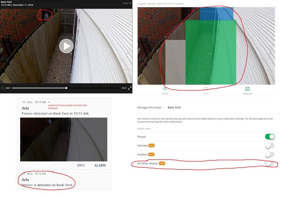

I'd just like to share an illustration with you all, and HOPEFULLY TO SOMEONE WITHING ARLO'S TECH SUPPORT WHO CAN ACTUALLY MAKE ANY SMALL AMOUNT OF IMPROVEMENT TO THIS RIDICULOUS APP. This is an illustration of me receiving 5 total alerts for both a person (4/ea) and general motion (1/ea), outside of my activity zones, on a camera which is not supposed to even notify me for general motion. Galaxy S9. Android 8. Please stop making me feel like I've been ripped off. No, I'm not going to reset my base station any re-sync my cameras yet again. Thanks.
