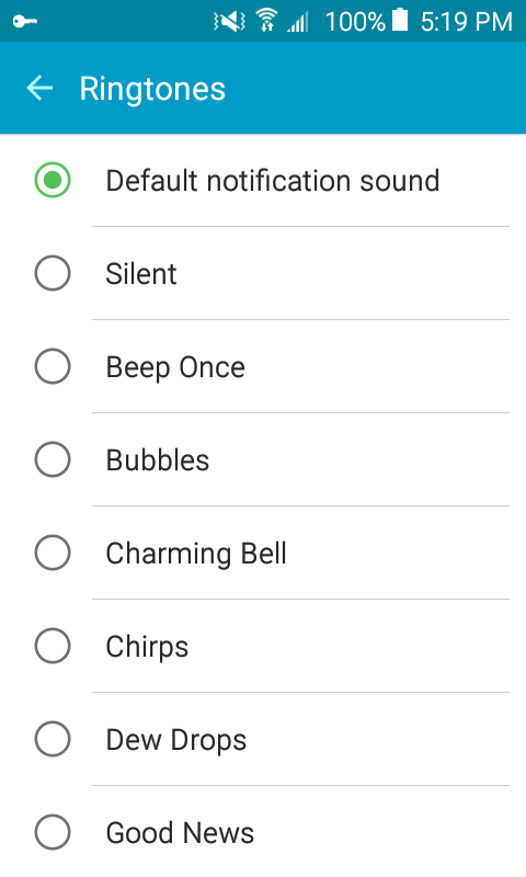

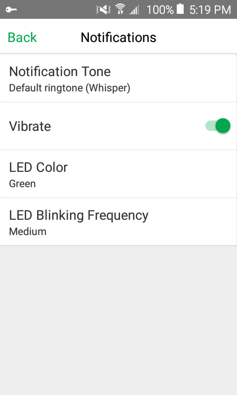

I was hoping that the new update (released 11/28/2018) would fix this issue, but it has not.
Bottom line, the audio notification reverts to the phone's default sound notification. I have tried to change the sound in the Arlo app notification menu to no avail.
Phone: Samsung Galaxy S8
JTRAN80
in the android OS, go to
Settings>Apps & Notifications>App info>Arlo>App notifications>under categories "Notifications">Sounds
Jixxy
Thanks for the info, solved my problem.
