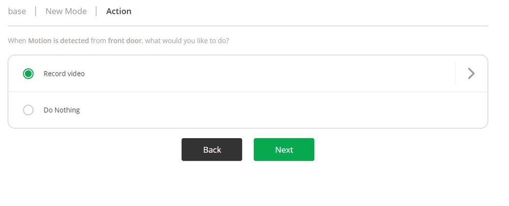

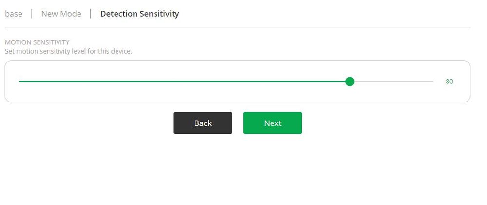

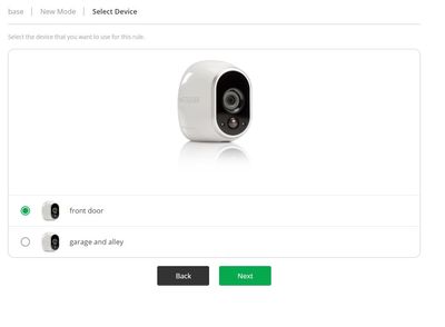

Screenshots below of step by step in browser of my options (with no activity zone) when creating a new mode in my broswer (it's no different in the Android app btw):
I can create activity zones, but then I have no ability to do anything further with them. Nothing comes up with regard to activity zones when I create a new mode, or even try to edit an old mode (which from FAQs and other community searches it's my understanding is where they should come into play?).

Would help to know if there is anyone that can actully select activty zones from the mode menu at this point or if that feature is just an unfinished gimmik.
I believe Smart zones are just applied and are not selectable.

Except all the instructional materials say that they are selectable, and that you should be able to do so when creating a Mode.
Activity zones from an AC-powered camera (Q and Pro 2) are selectable. Smart zones are not.
