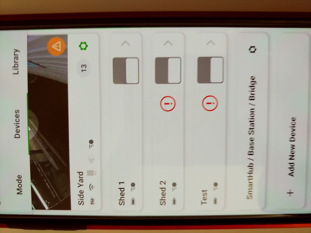

I installed two security lights last night and one light has a red exclamation mark next to the on/off toggle. The other light does not. What is this? Also, the light is picking up motion but is not lighting up yet I can manually turn the light on and off. Does one have something to do with the other?
Thanks for any help provided.

@michaelkenward Started from scratch with the bridge and 3 cameras. 2 of the 3 cameras on the app show red exclamation marks next to two of the on/off toggles. What is this? Also, I am only able to set the "Dusk to Dawn" sensitivity on one camera. Please see attached pic showing app.

I had this issue also on a brand new light (three other lights did not have the !) So I checked the firmware and the new light was on 3.2.26 while the others were 3.2.51. The new light said "no updates available" also. Then two days later the ! was gone and the light got updated - along with Dusk to Dawn being added.
Seems you just have to be patient, unless there's a way to force the firmware update?

I chip in only to say that you may be able to provoke the firmware update by restarting the system a few times.
It seems that in some circumstances the process of logging into the system causes the various components to go out and look for new firmware.

The most up to date firmware must have finally kicked in. No more red exclamations. Took a long time though.
