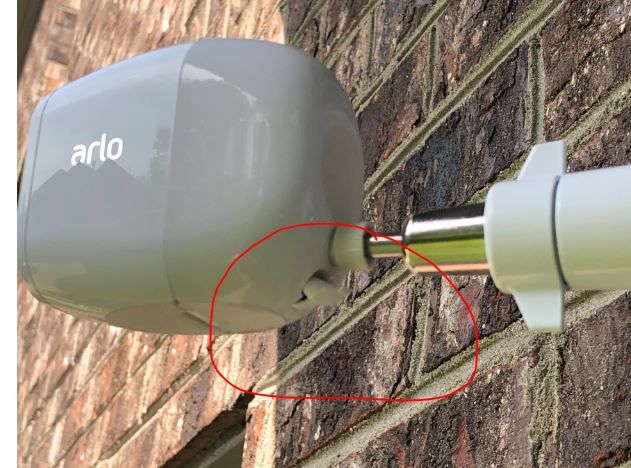

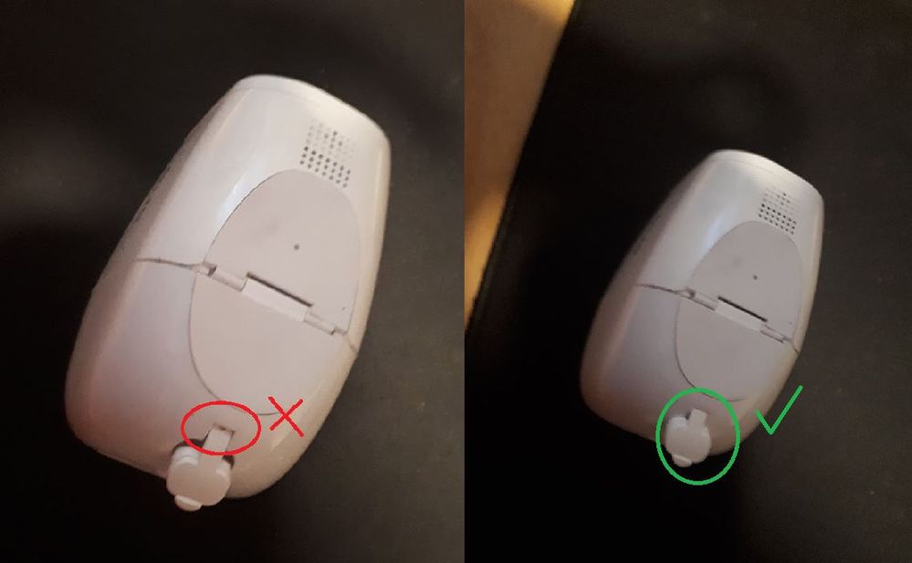

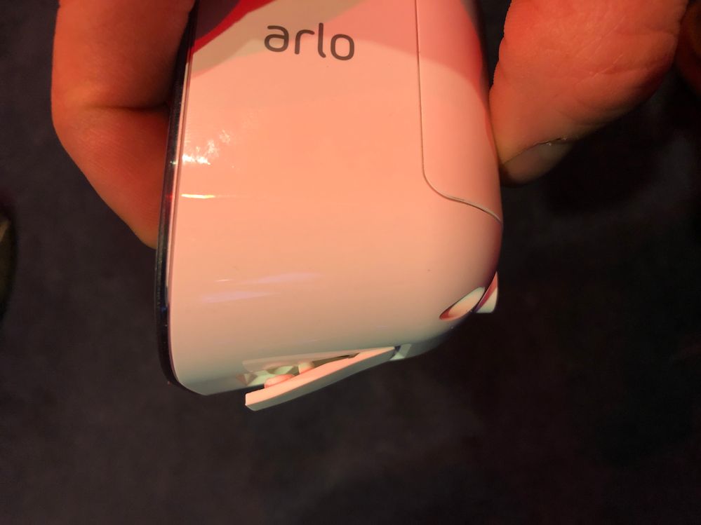

I have the Pro 2 and wanted to share a similar experience after taking down my Pro 2 for charging.  When taking the cover off, I must have pulled on the cover which gave it some more slack.  The extra slack would force the cover to pop off and not stay on.  After pushing the cover to reduce the slack, I was then able to close the cover (and have it stay closed).
The attached picture shows what I encountered (sorry for the blurriness).
StephenB
I agree the rubber plug is a weakness in the design (which was addressed in the newer cameras, which use a magnetic coupling that doesn't need a plug).
It works ok if you are careful with it.  Some have applied some silicon grease around it, in order to prevent water from leaking in around the edges.
