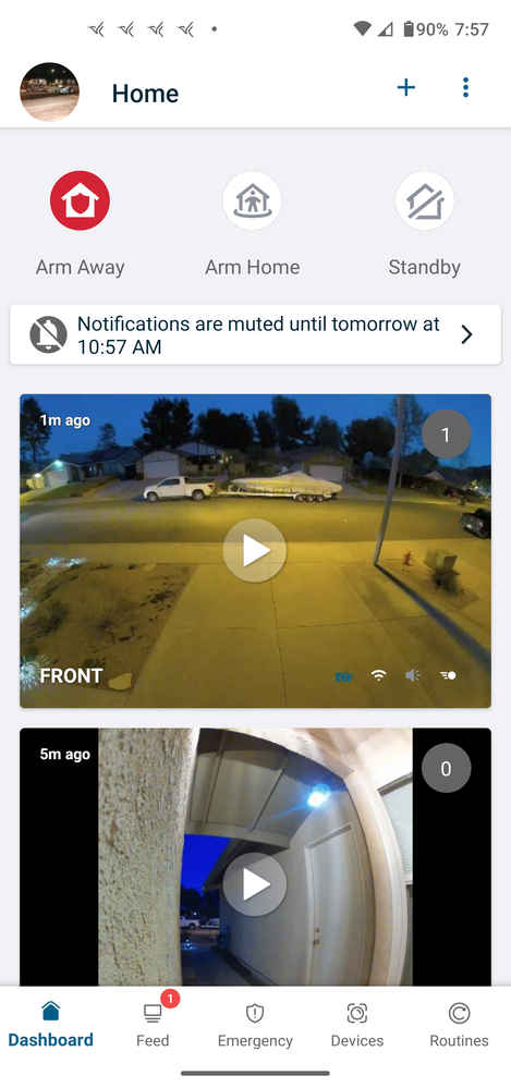

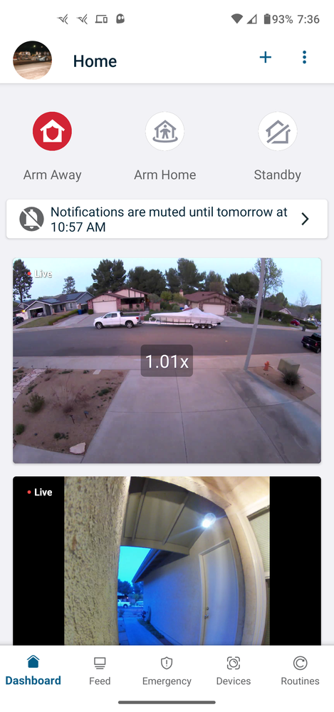

Spent some time on the lights sending push notifications while muted...double checked all settings and tried different scenarios. My mistake yesterday when I said I turned on push notifications on a third light (front) and it did not send push notifications when muted...I forgot to hit save so it never got turned but last night when it was turned on (push) it sent push notifications, just like the other lights, when notifications were muted.

Time – 7:36 pm...muted until 10:57 am the next morning
Time – 7:36 pm...three pushes that came through while muted until 10:57
Time – 7:56 pm...another push at 7:55 pm while still muted until 10:57

Note that camera push notifications are fine and do not come through when muted.
