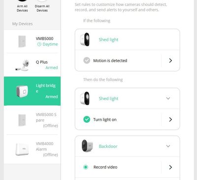

Not sure what you mean by "Security Light". If you mean the old lights that use the "Light bridge", then you can get that to trigger the Pro 2.
Start with a Mode for the Light bridge.
  • If Motion on Shed light
  • Add Device
  • Pro 2
Proceed as usual.
Does that get what you want?

When I go into the rules for a mode, I can add a rule for the light.  That rule lets me add "record a video" as an action (specifying what camera I want to make that recording on).
It'd be useful to know how far you can go down that path.
  1. If the light is not in your rule list, are you seeing the light as an option when you add a rule to your existing modes?
  2. When you edit that rule, are you able to add an action to record a video?

So you have the Arlo Spotlight listed as a rule in Arm Away.
When I go into that rule, I see
When I then "add an Action", I see
I check "record a video" (as shown), and then press "next" in the upper right.  That gives me a list of cameras, so I can chose which one records.

Taking that one stage further, this is the screen I get to:
I also have the light set to trigger other cameras and a floodlight.
