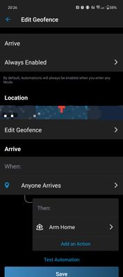

Hello everyone, my geofencing doesn't seem to be working anymore. I've already tried everything (rebooting the base station, camera, and smartphone) - no success.

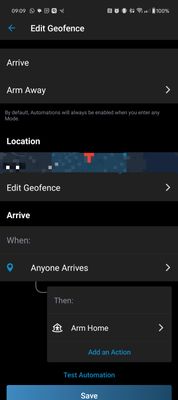

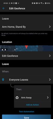

Generally, if you want to combine geofencing + scheduling, you need to reserve "Arm Away" for when you are away. Then schedule mode switches between "Arm Home" and "Standby" when you are home. The sometimes requires you to repurpose "Standby" (enabling some cameras).
The schedule automations are enabled in "Arm Home" and "Standby", but disabled in Arm Away"). "Arrive" is only enabled in "Arm Away". "Leave" can be always enabled, but it is also fine to enable it only in "Arm Home" and "Standby".
Thank you for this, this setup is completely new to me.
Over night, it went to arm away, and now won't switch back, if I switch it, it goes back to arm away. This is the usual behaviour but I used to get a few days with it working in my originally provided config. It's like once it's done each mode once it gets stuck in the last mode.
I think I've now (as of about 09:10) set it up as you've said, screenshots below:
