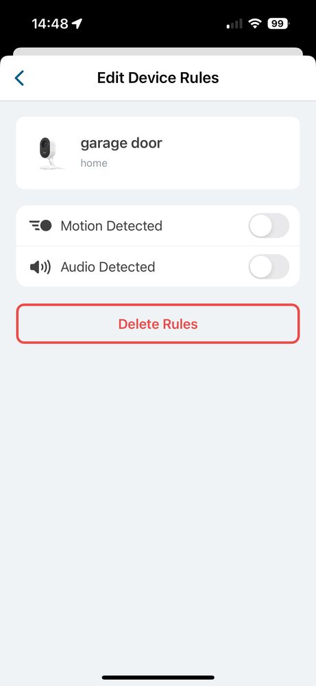

Here are my standby settings:
Now that I have purchased a subscription and I no longer get alerts in standby mode I am unable to test until my subscription expires.
