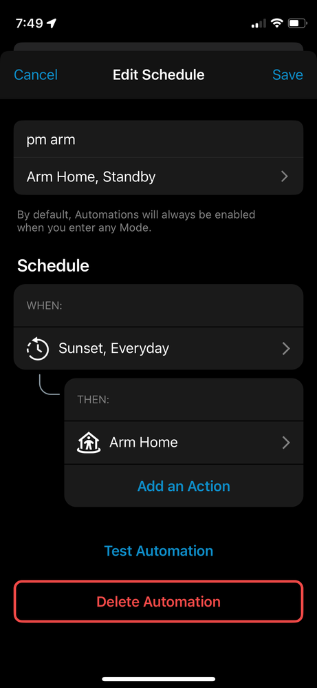

When you set up the automations, you want
- Scheduling automations to be enabled in both Arm Home and Standby
- Geofencing Leave to be always enabled
- Geofencing Arrive to be enabled in Arm Away only.
Here are some screenshots you can use as models (the times are not what you want, but everything else is). Pay particular attention to the enable lists (which are right underneath the automation names).
