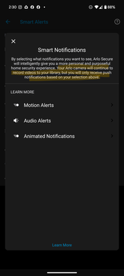

As of August 28th my cameras no longer capture any recordings for events which are not apart of my smart notification settings. As an example, my cameras used to always record my dogs in the backyard and properly tag them as animals without notifying me, now I have found these events are not being recorded and is impacting all my cameras as of August 28th. If I do turn on smart notifications for animals they are now again recording but of course sending me a push notification which I don't want.

The development team has completed a cloud release resolving the issues some users experienced with suppressed recordings from Smart Detection settings.
With this release, all recordings should be visible in the library/feed regardless of the selections made with Smart Detection toggles unless the event takes place outside of a user defined Activity Zone.
After further investigation, the development team has identified the cause behind some users continuing to see missing video clips when smart notifications for specific events are toggled off. We will be releasing a cloud side fix later this week to address these concerns.
We appreciate your patience and feedback while we work to resolve these issues. I will provide another update once we have more information available to share
I realize there is a lot of confusion in this thread due to the recent changes we rolled out. I apologize for all the frustration this has caused. Currently, we've rolled back the changes but we're continuing to investigate reports from users about a few unexpected behaviors they are still experiencing.
1.) Video clip deletion when smart toggles are turned off. This results in recordings not arriving in the library or feed when the smart classification toggle is turned off (for example, Vehicles are turned off, resulting in no notification or recording). This change was rolled back but some users are reporting they are still experiencing this behavior. The development team is actively investigating these reports. The intent after we rolled back the changes is for all event recording to be saved to the library/feed regardless of your Smart Alert and Smart Detection toggles (unless the motion is outside of a defined Activity Zone in which case it will be discarded as expected).
2.) When all motion or all other motion is turned on but smart notification toggles are turned off, clips for these events are arriving as expected in the library/feed but they don't have a classification label, whereas previously they would still have a vehicle label even if vehicle notifications was turned off for example.
3.) In the latest version of the Arlo app, there is confusing verbiage in the Smart Notifications toggle area that states recordings will be suppressed when the toggles are turned off. This is the change that was rolled back and this is being updated in a new version of the app that will be released soon.
The development team is working hard to revert these changes to the previous expected behaviors, I will provide more information as soon as I can.

"We are updating the Smart Notifications toggle to enhance your experience" - this isn't an enhancement, and if it was, where was the change control? Documentation? Release notes? The latest version of Arlo app in the Apple store says nothing about this "enhancement". Your own support folks know nothing about this.
"Previously, this feature suppressed push notifications for selected smart detections" - I've had this app for years and that has never been the case. If the smart notification toggle for animal is turned on, you get a push notification on your phone for "Animal detected on ...camera". That is how it was designed to work and that is how it worked.
"...and customers reported feeling overwhelmed by every motion-triggered event appearing in their Library and Feed" - That doesn't even make sense. First of all, the only thing overwhelming is when you get too many push notifications. It makes using your phone difficult because you are always having to swipe away alerts when you are trying to do other things on your phone. That's the whole point of being able to control that using Smart Notifications. Second, if customers were actually overwhelmed when looking at their library full of recordings they could have adjusted what they saw using the "Filter" option in their library. If they were recording too many videos they could have adjusted their camera sensitivity.
"Based on your feedback" - Whose feedback??? Not ours! Please point us all to the thread where people are actually asking for this.
", we are now expanding this functionality to also suppress recordings for these events"." - If you want to expand functionality then give users another toggle to decide whether or not to suppress recording. Don't embed it into a setting for a push notification.
