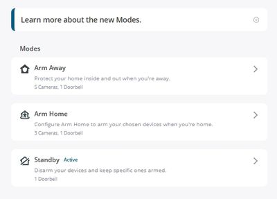

I have been an Arlo user for years but recently, and specifically after I added Solar Power to one of my cameras, the modes and schedules have stopped working.  It has been close to a month now and I'm tired of calling Arlo support which is basically "I'm Sorry".  I have spent well over $1000 on this system and expect it to work.
Basically, during Standy which should begin at 6:00am, only my Doorbell camera should be operational.  If I move it manually to Standby it does so and works accordingly.  During Arm Home, which should become active at 9:00PM, four outside cameras should become active.
Arlo Support has been useless - I can provide screen shots if this is helpful.  Any input would be appreciated.

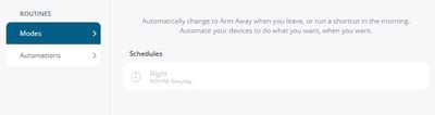

@N5XTH wrote:
here is a screen shot of the Website version - Note that only one automation is shown and is greyed out.  It cannot be edited.  The Day automation is not shown at all.  On both my tablet and phone, I can edit it as needed.
You might want to post more of the screen. But you need to click on automations (right below "Modes").  You don't edit the automations from "Modes".

N5XTH
I will attach screen shots from both my phone (android system) as well as my Windows 11 PC.  They do not match and the Windows attempts to change the system do not work.  One other thing which I did not mention - My Arm Home is scheduled for everyday at 9PM.  It works everyday at 6AM when I have already put it into Standby Mode.
From My PC:
PLEASE NOTE THAT ON THE PC ONLY THE NIGHT SCHEDULE IS VISIBLE TO ME AND IT CANNOT BE EDITED.  IT IS ALL CORRECT ON MY PHONE AND TABLET.
Any help would be appreciated.

N5XTH

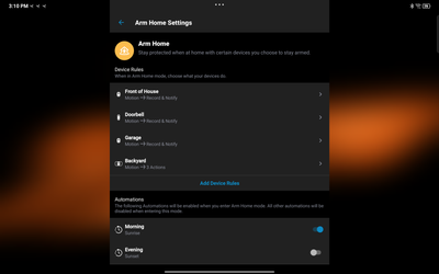

N5XTH
Ok - so nothing I have done has worked.  I have now eliminated all schedules and re-entered them.  I have moved to a Sunrise and sunset schedule.  At Sunrise - we move to Standby; at Sunset we move to Arm Home.  I have attached all screenshots.  PLEASE HELP!
please let me know if any other screen shots are needed.
StephenB
You didn't show the evening automation (or Arm Home).
"Morning" is configured to trigger when the system is already in "Arm Home" mode at sunrise, and will switch to "Stand by".  That should work (assuming the system was in Arm Home at night).
"Evening" should be symmetric - configured to trigger when the system is already in "Stand by" at Sunset, and switch to "Arm Home".

Adam_B
Hello @N5XTH -- I am just joining the conversation so let me try to summarize what I can see here:
You have 2 schedules, 'Morning' and 'Evening'
  • Your Morning schedule is only triggered if your active mode is ARM HOME at SUNRISE and it will change the mode to STANDBY.
  • Your Evening schedule is only triggered if your active mode is STANDBY at SUNSET and it will change the mode to ARM HOME.
  • I also see that your 'Morning' schedule is DISABLED and your 'Evening' schedule is ENABLED.
Do you agree with this?
StephenB
Just want to add that the system was in STANDBY when the screenshot was taken, so this is consistent with the automation enable list.
