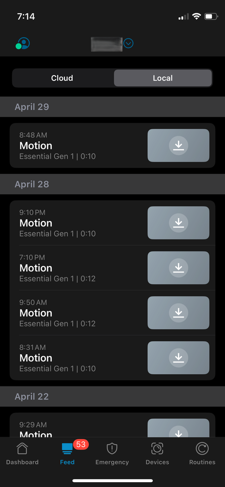

it still fine few days ago (early May 2025) but the local storage function isn’t work on app. We are suppose to have cloud/local button for choosing when we are in home network. But this button is now disappear and we have no way to access the local storage video thru app. Can anyone help?

Do you see "Feed" and "Dashboard" in your app menu? Or do you instead see "Library"?
Android or iOS? I just responded to someone whose app was updated to 6.0.2 (which isn't available for Android yet) that has the same/similar issue.
I saw feed and dashbcard. It was supposed can see cloud and local at FEED. But nothing can no longer see it now
6.0.2 was released May 1. It is running on my iPhone (and I do see the "Local" tab on the "Feed" Screen).

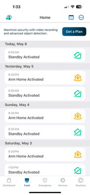

I have also just updated to 6.0.2 and still under storage setting, there are no local recordings displayed
Under the device 'no event' is shown
Under Feed no local tab

I started having the same problem, on iPhone with the app update. If I select feed, Cloud and Local will sometimes appear but now even if I see the Local option it will say there are no events. If I open and close the app a number of times eventually the events will populate. If I close the app and re-open it they will be gone again. I also can not access them by going directly into the base station as it just shows the record locally button which is on but no events.
