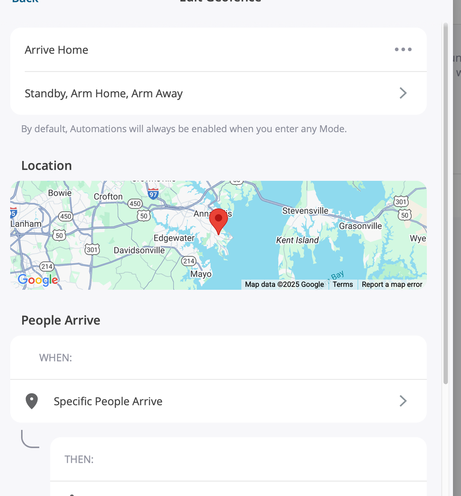

I suspect the enable lists are incorrect. Can you post screenshots of "leaving" and "arriving"?
The enable list is right under the automation name.
"leave home" is only enabled in Arm Away mode. Which means it will not run when the system is in "Arm Home" or "Standby". It should be always enabled. You can fix that by going into the "Arm Home" and "Standby" screens and enabling that automation there.
On the other hand, "arrive home" is always enabled. So if you have two people using geofencing, it will run again when the second person returns home. It should only be enabled in "Arm Away".
