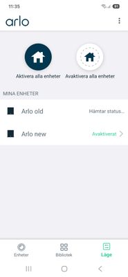

Chief-kir
  I bought a new hub to try it out så the new one works but the old one (the one with siren) just keep trying to get status . I have attached both from the android-app and the desktop version.
