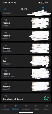

I detects motion when its in standby mode. Like the picture below you can follow the timeline.
So for example if i restart all my cameras whilst in standby they stay in that mode forever. So they never detect anything even if the app is in arms away. And vice versa, so If i go to the camera settings and restart them while im in arms away mode they keep detecting forever even if im in standby. I can easily change modes in the app, and it notifies me that i changed mode, but its like the cameras are stuck in the same mode forever.

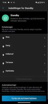

I have seen some other posters say that their cameras detect motion in "Standby". That sounds similar to your second issue. One says that if they modify standby to add rules for each camera that do not notify or record, then the unwanted notifications and recordings stopped.
I haven't seen anyone else reporting anything like your first issue.
Hi ive tried restarting the cameras in different modes, and no matter what they always detect motion.
Ive tried adding the rules to standby mode, but the problem persist.
