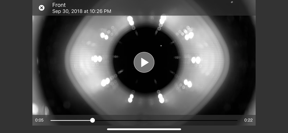

Q stops recording at night and has this image
  • 2 Replies
  • 1412 Views
  • 2 Likes
  • 2 In Conversation
sbndogg
I have an issue where my arlo records fine for most of the day up to about 9PM. From 9PM to 6AM, the camera stops recording and shows the attached image. I tried to change the schedules from recording all day to split schedules and even a special night schedule. It still doesn't correct the issue. I even took a camera from another location and swapped it with the one in the affected location. Same thing happenned. The second camera was having this same behavior.
When I bought the cameras, it recorded fine 24 hours a day in this same location. I'm not sure why it is not working now and even when I swap with a second camera.
Any help would be appreciated. Thanks in advanced.
You're looking through glass with Night Vision enabled. That's the IR illuminators reflecting off the glass. Disable Night Vision.
2 REPLIES 2
sbndogg
Thanks so much. This indeed was the issue. Thank You so much as I was at my wits end.
