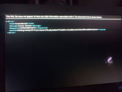

I used to be able to watch my Arlo Q cameras in all my 4 Google Nest hubs at home; however, now all I get is an annoying code message in all nest hubs when trying to watch my cameras in them.
Message:
"this xml file does not appear to have any style information associated to it. the document tree is shown below."
I can watch the cameras in the Google Home app in my cell without issues but the issue prevails in the hubs as I have factory deleted them and re-linked the Arlo app besides doing other ts that Google support advised..
Any advice would be appretiated

What is the version of the Google Home Hub? Also, the version of the Google Home app(screenshot of the Arlo cameras showing in the Google Home app) Are there any other devices working with Google Home Hub? Was there any updates performed and if so on which app?

I'm having the same problem he is having but I'm using the Arlo Essentials indoor camera. I'm using the Google Nest hub (2nd Gen). There is only one other device other than the camera working with the Google Home Hub which is a single smart outlet. The hub and camera are brand new so there was a firmware update before starting. Same as him I can't see the feed through the hub, but I can see it through my phone.

Do older Arlo cameras like Arlo Baby ABC1000 show an XLM "Access Denied" page instead of a feed on Google Home Hubs because Arlo no longer supports them? If so, may you please confirm the list of cameras no longer supported? Or is there a fix ETA? Thanks!
BrookeN
The Arlo Q, Arlo Baby the VMC3030 are not supported. The Pro and Pro 2 are not supported at this moment, but that is being looked into.

StephenB
@Plasmadevil wrote:
So, it's no longer supported anymore when a couple of weeks ago it was working just fine. Wonderful!
To be clear, I think @BrookeN was talking only about Google Home.
It does look like Arlo removed the feature, since the Q cameras are listed in the 2021 version of the KB article:
But not in the Nov 2023 version
@JamesC , @BrookeN , @ShayneS :
The Q / Q Plus cameras don't go end-of-life until 1 January 2025.  Is there any explanation on why Arlo removed support for Google Home for these cameras?
BrookeN
There is hardware limitations with the streaming of those certain devices. The other functions should still work correctly.
StephenB
Well, it's been working for some years with the Q/Q Plus.
Did Google change something on their end???
BrookeN
The Q and Q Plus have always worked with the Google Home, however they should have not been able to stream.
