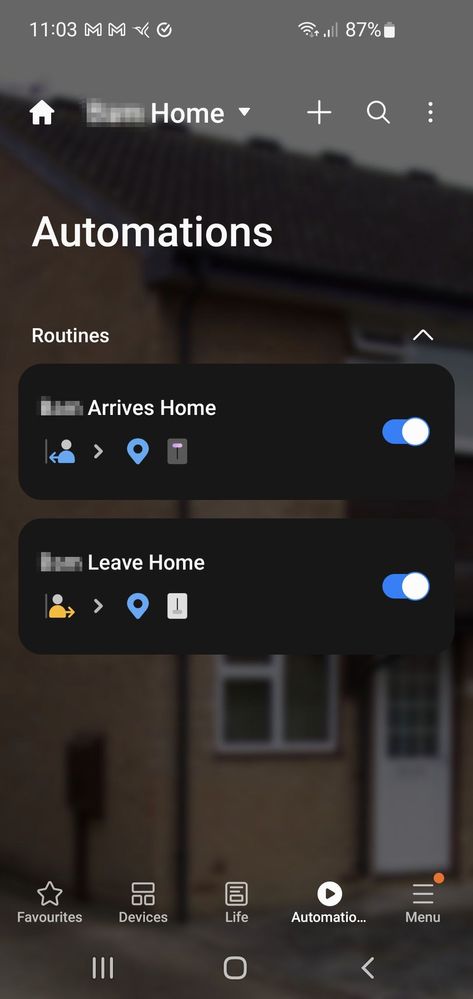

I have 2 Routines that monitor my location and perform various tasks when I enter or leave the zone(s). I say zones because unlike Google Home you can setup multiple locations and change the trigger radius.
I've tried Google Home and IFTTT location triggers and neither work reliably.
In this example when I arrive/depart it switches my location status and turns on/off a power socket :
