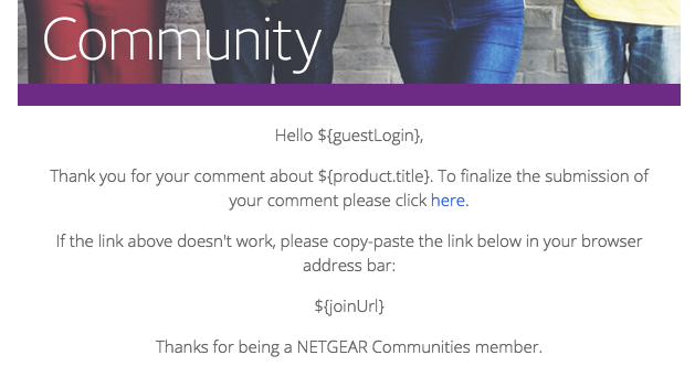

Also, the notification email I received for your reply looked like this:
Which is odd since:
- The email template was incorrect, since this was generated by your response to my post, and I didn't attempt to submit a comment on anything.
- The variables were not filled in : )
Not sure how to report this.
Glaphmion,
Thank you for bringing this to my attention, I will escalate this report accordingly.
