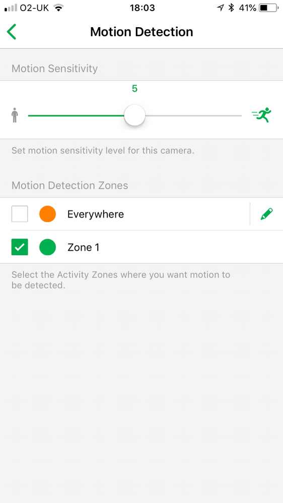

I just bought an Arlo Q (VMC3040), but cannot get it to honor the motion detection zones I have set up.
Below are my zone and mode settings. Nothing in the street should be triggering motion, but when cars drive by, it records the motion. I've tried restarting the camera, but it still triggers when cars drive by in the street.

Now that you've set up the zones, have you enabled them in your modes and rules? Mode tab, select your camera and edit your modes so that zones are utilized.
Yes, I enabled the zones (see the picture labeled Mode Settings in the original post).

When setting up detection zones, you must select the zones you would like to include motion detection within the modes/rules for each camera. Have you done that in addition to creating the detection zones for each camera?

I just tested using activity zones and did not experience any issue. Do you have the appropriate rules set so that your zones detect motion rather than the cameras entire field of view?
Log in to your Arlo account and navigate to Mode, select your camera and edit your active mode. Edit the rule for your camera and then edit the Motion Detected setting. This will show you based on the zones you have created a list of zones to enable or disable for motion detection.

Did you enable the zones in your modes? They're not automatically used in the Q cameras.

When you say the zones are not working, what is it specifically that you're experiencing? Are you getting detection events from motion outside the zones? No motion events at all?
Also, a screenshot of your zones and your cameras view may give us a better understand of the issue you're experiencing.
While the customer support in Japan had previously explained to me that the false detection bug had been reproduced in their environment too and their dept. in charge was fixing the bug, I received their mail a few days ago saying there was a mistake in their test setting, and they want to make sure I do not make the same mistake as theirs.
They said they tested detection without enabling the created zone in the mode setting, and so they want me to send them the screenshot of my mode setting window indicating which zone is enabled.
I sent them back the screenshot right away, but honestly I was amazed to read the mail. What are they doing at this moment ? I do not make such a primitive mistake, nor do most users reporting the bug here.
