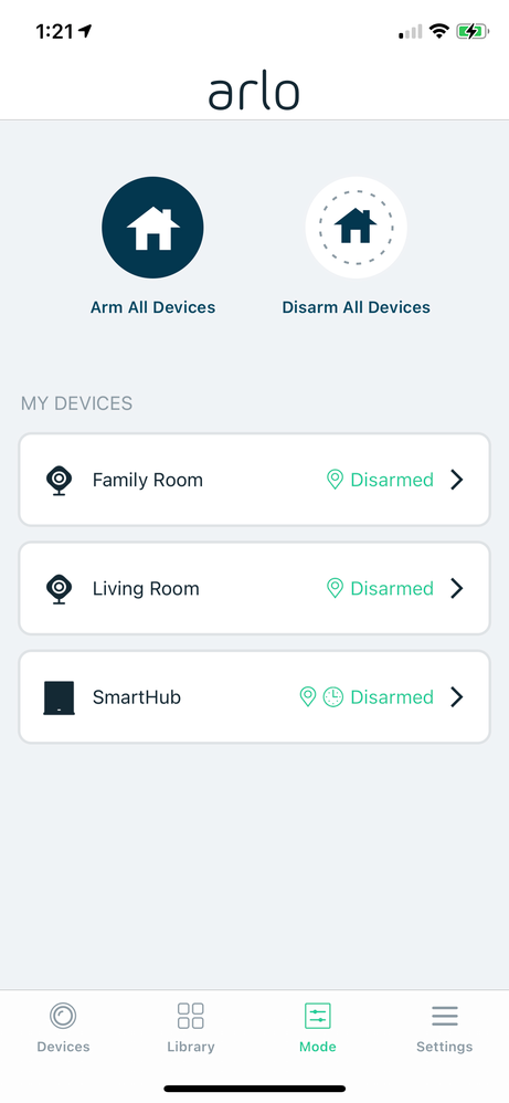

Hello,
My Arlo Q cameras are no longer working with GeoFencing.  When I change the GeoFencing location to somewhere away from me, the mode won't change.
Works fine on the SmartHub.
Basic example that works on the SmartHub, but not the Q:
- Go into GeoFencing settings
-Change camera location to somewhere far away
-Expect a notification and for it to change to the Away mode; it does not.
This also seems to impact the combination of GeoFencing with the Home mode being "Schedule".
Anyone else seeing this?  I've tried removing and re-adding the camera, as well as troubleshooting steps online.
Here's another screen shot that seems to show a problem. Both cameras are setup the same on the mobile app, but...see how they look different?

This is now fixed. They updated their servers tonight.
