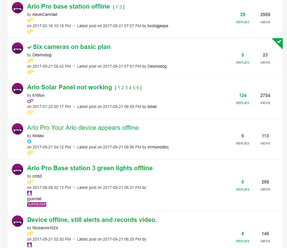

Similar issue to this thread: https://community.netgear.com/t5/Arlo/arlo-saying-base-station-is-offline/td-p/1021427
Arlo has been showing as offline for hours saying "Base station is disconnected" and thereby all of my cameras. Except when I go to my library it's still recording videos.
