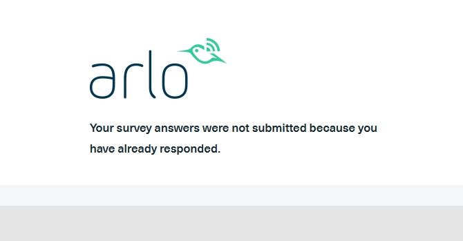

And after I answer all questions and clicked submit, I got this screen.: Your survey answers were not submitted because you have already responded.!
Very professional, why waste my time and ask if you know the answer, or don’t want to hear it.
