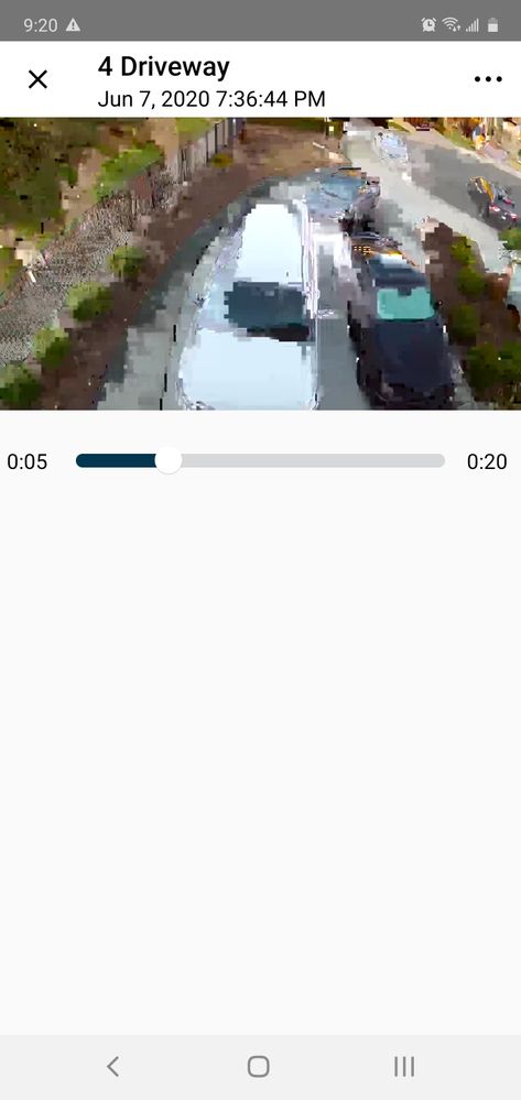

Since the early hours of yesterday morning (25th April) UK time all of my Arlo Pro cameras have been suffering from extreme pixelation in both live view and motion detection recordings. The location of the cameras and base station have not changed for months.
The base station is VMB4000r3 on firmware 1.16.1.1_3348_facf74c
The four cameras are version H8 1.092.0.25_24_986
The pixelated video is also present on local USB storage suggesting a local issue.
I have checked WiFi strength using an analyser and all is good. All cameras have three bars in the Arlo app.
One of the cameras is within ten feet of the base station with no obstructions and is suffering the same.
I have noticed that a camera firmware update was issued in the last few days. Are there any known problems that could have caused such a drastic change in system performance?

Thank you so much for your feedback. Please see the response below from our Engineering team as to why the video quality is not entirely the same as before.. "With more than 4.25 million registered accounts serving up more than 144 million video events a day, Arlo has become a massive platform, users rely on every day, one that now also delivers AI and computer vision processing. To maintain a platform of this size, we continually review and adjust our variable video compression, which optimizes the size of videos transmitted to and from our platform. It seems that for some users, particularly those with cameras in high-traffic areas, the dynamic video compression resulted in poor video quality, so we’ve updated the software to improve the variable video compression algorithm".

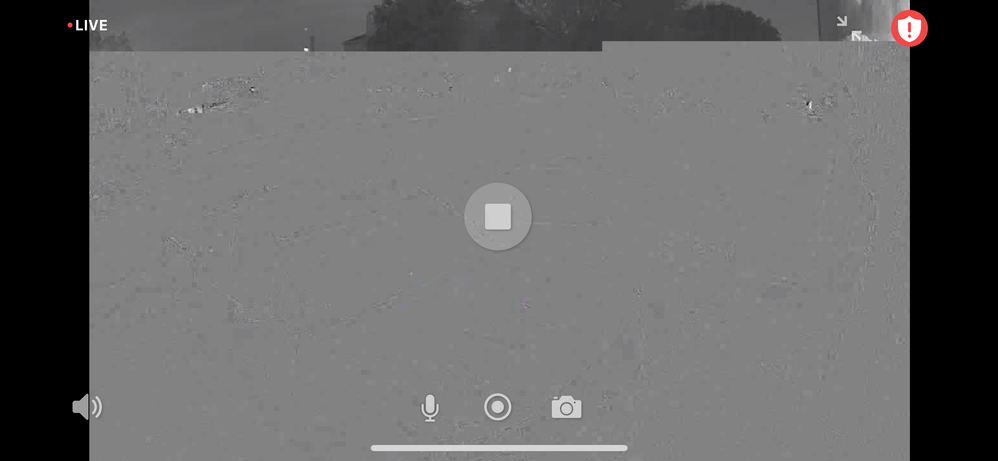

My Arlo Pro cameras recently received a firmware upgrade to 1.092.0.25_24_986 and now all my cameras have ghosting and lines in the video especially when there is fast movement. I'm 'this' close to dumping my Arlo system... it's like they do no DEV or TQA testing at all. Is anyone else having these issues (see attached)

That's pixelation. It's frequently caused by weak signal between the base and camera or by 2.4GHz interference. It's also possible that you upload speed is limited - have you tested it with speedtest.net lately?
